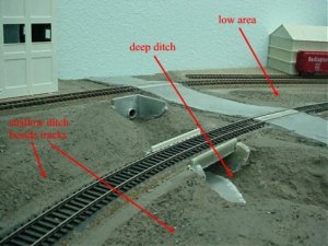

    I don't know, I kind of like the 1/4" birch plywood under my foam. If gives me a place to attach turn-out throw mechanisms, wiring, relays, electromagnets, terminal strips.
    I used 1" x 2" ripped from plywood for the frame, 1/4" birch on that, and 2" blue foam on top. It is fairly light, and works beautifully, and I wouldn't do it any other way. Here's some examples.
    [​IMG]
    [​IMG]
    [​IMG]
    [​IMG]
    [​IMG]

    Wow -- that looks nice and clean. Good starting point!
    And I can see how the plywood is handy for mounting things. It's just not a lot of use in supporting the foam, I had thought.

    You are probably correct on that. The 2" foam is probably stronger than the 1/4" plywood! One of the best things about model railroading is there are 20 ways to accomplish any project. And it is fun to hang out on The Gauge to see all the different solutions.

    I guess it is obvious that I really like the foam.
    Hey Thomas_Fan, here is why I like it so much and recommend it. It is just so easy to make all the ditches, creeks, and low areas, simply by cutting and scooping out the foam, instead of cutting out plywood.
    Santa Fe Jack, I guess another reason I put the plywood underneath is because I knew I was going to be cutting some drainages in that are almost 2" deep, as thick as the foam.

    Hey Gary...That's A1 workmanship...!! What do you do for a living..??
    No spaghetti bowls of wiring in that layout..!! Great job..!! :thumb:
