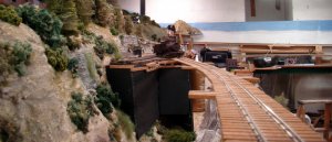

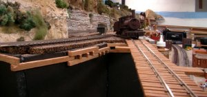

    Cribbing on the RR

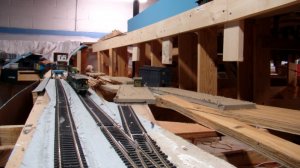

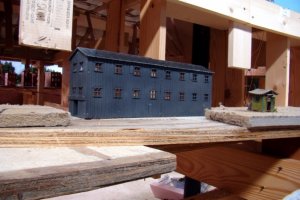

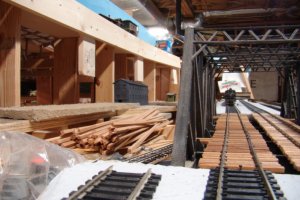

    A large sawmill complex is in the making
    Hi all,
    Here are some shots of the early construction of the J.E.Patterson Sawmill complex. This is going to be a very big complex with multiple logging related buildings and a good sized central sawmill.
    Reckon TRNL Bill will be along here soon to explain the goings on. It really is interesting.
    Bill, maybe you could sketch out a track plan for the good Zealot folks and I will digitalize it and get it going around this electronic campfire.
    Hope you all can visualize what Bill and I see here amongst the sticks and the homasote.
    Doc Tom:rolleyes:

    I can visualize a bit but cant wait to see what you come up with. :thumb:

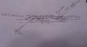

    I scratched out a track diagram, and am posting it here. Due to our long and painful experience, Tom and I are following the KISS principle (Keep It Simple Stupid) here; The track we are hand laying (everything between the switch off the passing siding, the backdrop and the crossing that leads to the coal mine) is having gentile curves and #6 switches.
    We don't have much depth to work with, and the log pond is taking up most of that. When I first started working with this area there was a hideously malformed lump of mountain that filled the space from the upper deck to the passing siding. In order to get space for a big sawmill, I tore out the mountain and installed a backdrop to get the room for a scene . To get room for proper operation, the loading docks are off scene, behind the back drop. We are going to try to hide where the track goes through the backdrop behind stacks of drying stacks and perhaps an elevated tram for green lumber handling . I likewise am putting in a long storage track for empty log cars, also behind the backdrop. Due to the angle of the backdrop, and the proximity to the creek that feeds the log pond. I'm thinking that I'll run the storage track through a building flat representing the car shops. Not a ideal solution , but better than a viable hole in the back drop.
    The sawmill and planing mill , and powerhouse will be represented with narrow flats on the backdrop, with the burner and most of the drying stacks painted on the backdrop. If we can pull this off, we will have the look of a big sawmill, and with the hidden tracks we will hopefully be able to deliver big log trains, and have enough to to pull long trains of lumber out of the mill.
    This is a minimalist plan, I don't have any engine or car facilities , a rip track, a track for machinery delivery. the only extra I have is the Company store/Office/warehouse. The one on my own railroad in Crooked Creek has been very useful operationally both as a delivery location for boxcars, and also a place to pick up boxcars of supplies for the log camps.
    I really like the way I have used the sawmill track to access the coal mine at the wall side of the peninsula. this will help keep the mill switcher busy, if we have a dedicated mill switcher. the whole complex uses #6 switches and gentle curves; the plan is to make the track work bulletproof, so that big trains can be built up or delivered here without undue hastle.
    Before I started on the sawmill itself I did a whole lot of work to the mainline at this end of the club, to get it more reliable. It is a lot more fun when everything stays on the track, and a derailment is an unusual occurrence.

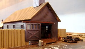

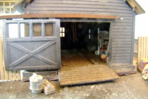

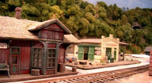

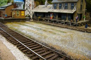

    Grab Shots
    Here are a couple more "grab shots" of the Clarksville Model RR layout.
    We are "blessed" to have a huge assortment of "donated" structures from model pikes that have been taken down because of house moves in this "army town" of ours. Here are a few of those structures being placed on the layout.
    Dr Tom:mrgreen:
  7. Mountain Man
    Mountain Man Active Member
    Jan 20, 2007
    1,709
    Outstanding work...:thumb:
  8. Sawdust
    Sawdust Member
    Nov 12, 2008
    261
    Looks really good Tom especially the colors of the buildings.
  9. ytter_man
    ytter_man Member
    Jun 12, 2008
    156
    Agreed, they look very nice.
    I also noticed the extra water tower in the background :thumb:
  10. steamhead
    steamhead Active Member
    Apr 17, 2005
    2,530
    That looks to be a very nice addition to the layout...!! Be sure to keep us posted on your progres...(or lack thereof)...:mrgreen:

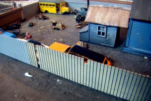

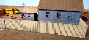

    Interesting model of an interesting prototype story
    Hi All,
    We had another operating session of the Clarksville Model RR club and it was a chance to get out the digital beast for a little railfanning.
    This is a very interesting model of an actual Church that was converted to a car garage and a junk yard.
    Hopefully Eric will be along here shortly to give the true to life story that inspired this very good modeling.
    Doc Tom:mrgreen:
  17. Cromagnon Mann
    Cromagnon Mann New Member
    Jul 26, 2009
    11
    Nice work. Would like to hear the story behind the building.
  18. ytter_man
    ytter_man Member
    Jun 12, 2008
    156
    People convert churches to garages there too eh?
    My best childhood friend's dad had a church on his property converted into a big garage. Unfortunately he heated the thing with coal and neglected to sweep his chimney, the place burned down several years ago :cry:
    The stained glass and all the church stuff had been moved to town long ago though. It looks a LOT like your model! :thumb:
  19. Bill Nelson
    Bill Nelson Well-Known Member
    Dec 15, 2008
    2,448
    148
    I believe the prototype for this structure eventually burnt as well. Eric said it was permeated by motor oil.
