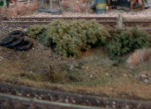

I use everything---sifted and demagnatized parking lot dirt, ground foam, sisal rope for weeds, pea gravel, different scales and colors of ballast, sawdust...even pencil shavings from a sharpener.
