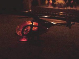

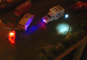

Well, I finally got my first LED street lamp made! Then I attacked the helicopter and here they are. Am I learning or what? Thank you to all for your knowledge that you have pasted on this site. I may be slow, but I am getting it done!

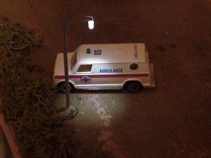

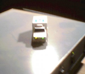

Ok, I went all this time. I took my EMS transport wagon, ripped it apart, then added lights under the hood. I installed 4 LED's ( 1 of each - bl,rd, yel and green)that all flash simultaneously with a flash rate of 10 fps. So tell me what you think!
The second photo shows the green and yellow as both on, but thier not! :thumb:
