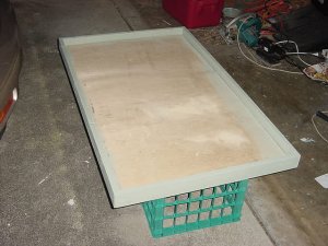

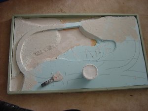

I've started work on a 2'4" X 4' layout. This will be a seaside layout similar to the one I posted pictures of in the Pictures of Old Layout thread. I missed the colors of the old layout. :(
Benchwork consists of a frame of 1X3's with a 1/4" plywood floor. Two layers of 1/2" blue foam cover the plywood and form the basic scenery. The track plan is a simple loop using Kato Unitrack.

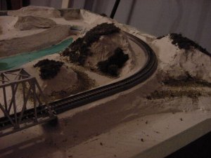

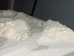

Sand Dunes
Here is a cut through the sand dunes. The foreman hopes to get some vegetation established soon so that maybe he won't have to keep digging out the track where the dunes have drifted in.
I used Great Stuff to form the dunes. When it hardens, I cut and shape the dunes and then cover them with joint compound.

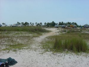

Looks like you got a very nice beachfront property started.
:thumb: :thumb:
Hey! That's what the beach 'round my way looks.
'Round her if'n ya' mess with the Sea Oats you get time in the pokey. :eek:
Sooo... the beaches (that arn't wall-to-wall bikini's) are all grassy-like.
Kinda nice at times. Gives a feel of being on an remote island.
Till the ankle biters come 'round with their rice burners thump'n. :mad:
P.S.- Some of those lil' suits are on VERY large bodies. Yuch! :eek: :eek:ops:

Thanks everybody for the encouraging words! Sir Prize, you have hit the nail on the head. If there were a prototype for this railroad, it would be up the coast and around the big bend from you in Northwest Florida. And, yes, I'm planning to have sea oats, too.

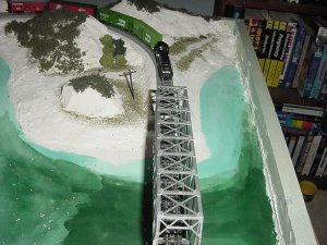

Foliage
OK, here's what it looks like now. Got some green stuff growing; got the place for the bridge cut out; and I'm waiting for the plaster to dry so I can finish painting the water.

Well, the plaster's dry, so out comes the paintbrush. A visiting railfan took a helicopter ride to get this picture.

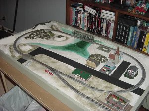

An update...
I've added some streets and tentatively set up buildings. Still need to add trees, figures, more foliage, and a gloss coat for the water. Even a small layout takes a lot of work. :D But, I have really enjoyed working on it. It's been like a breath of fresh air for my hobby.
