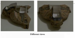

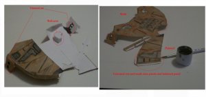

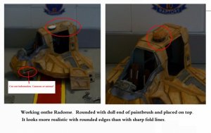

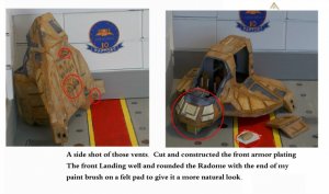

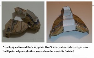

    I just started on the Raptor. Again thanks to JayBats. If I were to build it as designed, It would have been done already, but you know me, I have to experiment. The Raptor is coming along nicely, but I still have problems with the Bulge on the cockpit. Too much heat and it melted too much. Again, too much heat and it scorched the bubble. I am out of practice, it is one of those things that you have to practice.
    The engines have to go, I will re-do those. And now for the build and for your perusal enjoy the build. .:wave::wave::wave::wave:

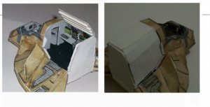

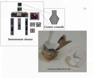

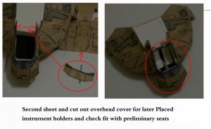

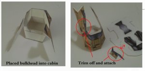

    Continue on with the Build. Scratch building the interior:wave::wave::wave::wave:

    Lookin' good! :thumb: If I may ask, how are you forming the clear canopy? Thermo-form or Vacu-form(sounds like Thermo-form)? This seems like a good time to use the Future canopy technique.
    Those consoles look great as well. Are they made from stills from the show or from decals?

    The canopy will be thermal form. I have to practice a bit more because it has to be done at a set distance, that is why it bubbled and bent the wrong way on my first two tries. For the later, I would have to use the lady's Orlik and she will not appreciate me messing with the hoses.
    The consoles are scratched built and the instruments came from photos of a Blackhawk. The blackhawk has a predominantly digital control panel, almost like on the BG fighters and ships. I broke the UH-60 console and move the components around to get what I thought might be correct, and reduced them to size.

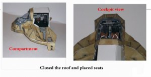

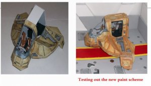

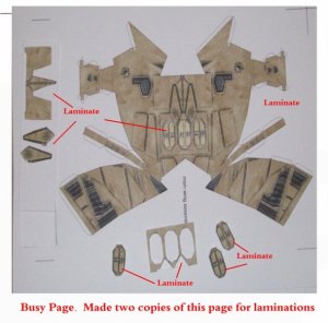

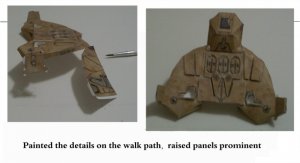

    A few more items. I printed double copies, because I wanted to have that raised panel look. The more I work with this model, the more small details I come up with and I have not even got to the engines yet.
    It is a shame that Dee committed suicide and what is up with Thrace? Who is she, another Starbuck from a parallel Universe?

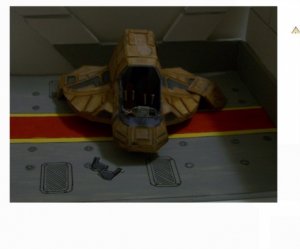

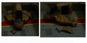

    Well here is a preliminary look at my color scheme. It is going well, but I am going to sweat over that Canopy at the end. It will give me time to practice and burn or melt more plastic.

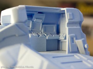

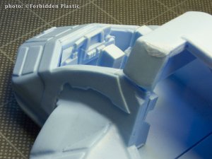

    The last two pics are reference on the interior lay-out. They are not complete, but enough to start off with.:wave::wave::wave::wave:

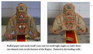

    Here is an update, I hope to finish soon but I may need to have a hiatus, due to an upcoming contract which may tie me up until 21 Feb.
    That attack Raptor is awesome, but it will be done by a better modeler than me, it is too intricate. If I were to do it, it would be the easier version, with only rocket launchers.
    I am working on the landing gears and done the schematics for the engines. It is almost there but not quite.:wave::wave::wave::wave:

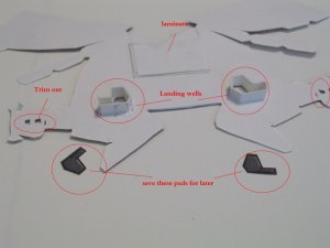

    just wondering, when you say laminate, do you mean sticking the paper textures on a thin card base?
    looking good, i was so-so when i first saw the raptor on the tv show. but it eventually grew on me, and the battle-raptor is just amazing looking.
  20. silveroxide
    silveroxide Well-Known Member
    Aug 23, 2007
    2,150
    487
    raptor
    I glue the paper illustration on posterboard and then I glue that cut piece on another piece of poster board, and so on until I get the desired thickness. On some pieces I do a 1X lamination and on other areas like the landing gear I may go as thick as 5X lamination for strength:wave::wave::wave::wave:
