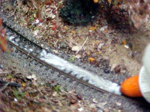

Drew1125
I use a small paper cup as a ballast spreader, squeezing in the top to form a pouring spout.
Then I pour a small amount of ballast down the middle of the track.
I work in short sections, doing about 12" of track at a time.

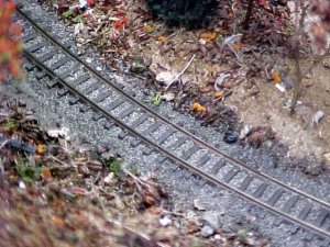

Drew1125
Now I take a softl brush, & gently sweep the ballast off the tie tops...the excess ballast will be pushed over the sides.
I just keep adding small amounts of ballast until it looks right to me.
Now this looks OK, but is just a little too "new" looking for me, so the next step will take care of that.

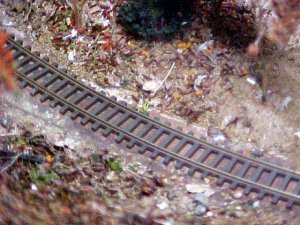

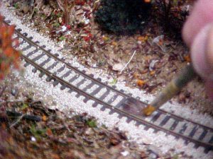

Drew1125
I wet the ballast with a black wash of alcohol & India ink...
This gives the ballast a dirtier look, & to me, blends in better with the surrounding scenery.
(for the black wash, I used a small bottle from a free sample of liquid detergent...it works great as a "eyedropper" type applicator)

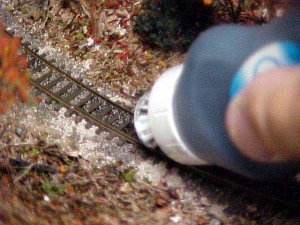

Drew1125
Next, I flow on a mixture of 50/50 white glue & water out of an old glue bottle...
