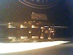

The first three locos are ones that Bachmann has been selling for years and years, and years..... you get the picture. I have One of each of them, they are identical. If you look at the bells and whistles and domes and piping and lights. One mold for all three types. They go for less than $50.00. the leading trucks and trailing trucks can be taken off one engine and put in the screw holes for another engine. The switcher is missing some side rods that the others have.
The 4-6-0 is a relatively new engine (post DCC) and sells for $100.00 or more. I think it has only been manufactured for a year or so, so you probably didn't get that in a box for $5.00
If you got an earlier made 4-6-0, and it was a real 4-6-0, not something someone made by sticking a 4 wheel pilot on the front, then the rear driver wheel would be over the cab/firebox. you can look at where that wheel is to determine if it is kitbashed or real. You can also look and the domes/bells/whistles/piping to see if it is an X-6-0.

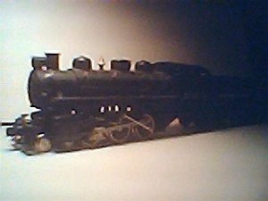

Thois is the "X-6-0" model you speak of. It appears that the four wheel pilot truck IS indeed a factory-made part! I'll post a picture of it soon, so you guys can see it.
GrorgeHO, I REALLY wish I could have found that 4-6-0 in a box for $5!! :D

You're right, you got one of the 0-6-0/2-6-0/2-6-2 locos, and the way the front truck looks, it could be factory installed, but I don't think they have produced that model (if ever) in a long time. The superstructure is obviously the same and the position of the drivers is also the same.
You can certainly order a UP tender for the 0-6-0 version, which will be a Vandy, and you can turn it into a 4-6-2 just by getting the trailing truck. These locos are very light, and I don't know if a 4-6-2 that light was ever made, but it would be Ok on a short line.

as far as i know that model has never actually been a factory model from bachmann, ypuve probably got a bashed one made using the leading truck from the older bachmann K4s Pacific

hum, thats more likely actually, would be about siutable size to not require modification to the basic chassis, will look up the part numbers on the destruction sheet i have for my UP switcher (yes i have got one myself along with one with a totally different tender that looks like a custom jobby)
