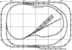

ok well cause i was thinking that the wheel flange is too big, i could change the wheels or no i cant gears UGH. maybe ill just stay away from atlas products, i do like the life like engines better, they are have MUCH better pick up, this GP just like stops and goes in this one spot ive cleaned tests continuity, then ran my life likes, not a problem. oh hey can i have some suggestions for my layout, this is going to be the finished product but im trying to see what type i should do, coal, conrete, rock, i dunno take the photo and draw it up let me know.
