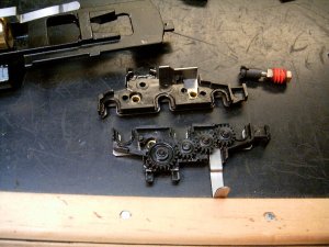

Back to the missing gear subject , I got 6 replaced the missing one and the other one that looked chewed up a littel . put it back in and it runs great . so I have a systen that is fine for now here is the picture of the box shy the gear .I do not think any one swaped out any parts .they just forgot to put in in .could have been produced on a monday friday .payday or even after lunch Do they still have liquid lunch breaks or are they Disco nap's

Interesting..Glad you got it running..
BTW..The reason I feel that engine was tampered with before you bought it is because I seen it before when I was working part time in a hobby shop.
