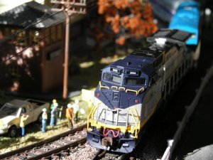

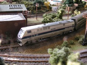

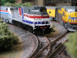

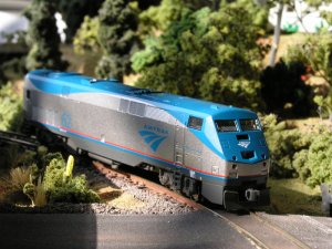

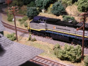

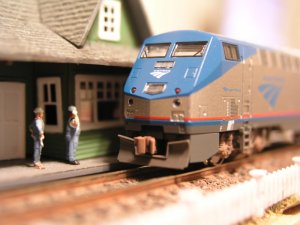

    Thanks...amazing what a little sunshine will do to improve the quality and realism of pictures. This is my first layout and it is still a "work in progress" adding realism and small details to cover up tons of little mistakes I made along the way. I've got the common problem of trying to do too much too quickly with too little experience. I forgot to answer your one question though...I used 9.75 in radius track, Bachmann EZ track actually. All of it is ballasted, weathered, and the only cars that give me any trouble negotiating the curves are the Concor passenger cars with the diaphrams between the cars. The Kato Superliners run fine and are made to handle the tight radius. There is a lot of overhang and I know the radius is really not prototypical - but I didn't have a choice when designing the layout. If you're interested in Nscale Amtrak, start looking and buying now. I'm finding that some of the cars and engines are getting harder to find at hobby stores and through online retailers - espicially if you want something unusual.
    Here's a few more pics -

    If that's Bachmann EZtrack then you deserve a medal -- the ballasting and weathering is a super job and you wouldn't ever know...

    Thank you very much...yep that's EZtrack. I found to ballast it - and get it to stick to the slippery plastic roadbed - I had to add a bit of carpenter's glue to the glue/water/dishwashing liquid mixture to give me that extra holding power. I learned alot from doing it, but the next layout will use more flextrack (less track joining) on cork roadbed. It took me three attempts at ballasting till I was happy with the results. Then like so many other layouts, it was just a matter of adding oil stains (using chalk of various colors) and coloring the ties here and there to break up the uniformity along with hand weathering the rails (next time I'm going to use spray paint). The real trick was weathering the turnouts. I found that hand painting them using mostly black inks gave them a much better appearance and covered all the extra metal that the EZ turnouts have.

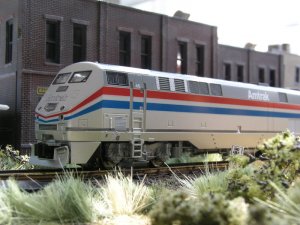

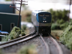

    Well here are two for now!

    Nice weathering Nscaler711! Did you use chalks?

    i used oil pastels and those must be Amfleets b/c no budds have been made

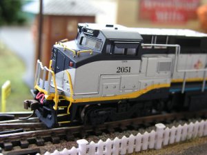

    Here is my P42 and SD70M
