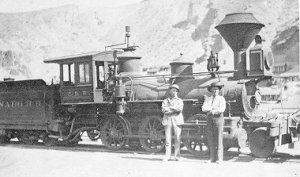

While browsing the LHS today, I noticed the bachmann "Jupiter" has a superstucture that is very simiar to the engine in the attached photo. The size of the bachmann model looks like it would look good as an HOn3 2-6-0, if a new mechanism could be constructed. Actually, this coronado RR loco looks nearly identical to a FED spartan 2-6-0 model - but I don't have the money for brass. I've estimated the driver diamiter of this engine to be around 45" based upon the train crew standing in front. a simple 2-6-0 chasis should be relatively easy to construct - if I can find 45" drivers. Anybody know of a source for these?
