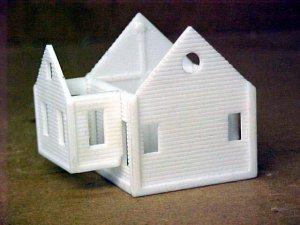

I was at my local hobby shop recently, & he had this kit marked down to $6...so I thought I'd see what a little "scratchin & bashin" do for it...

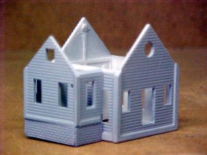

First, I threw out the kit roof (& the instructions :D)
I started by putting the little annex that's supposed to go on the back on the side, raising it so the roof line is even.

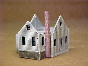

Drew1125
Then I found some HO brick walls in the scrap box, & made a foundation for the annex, & cut a new door opening

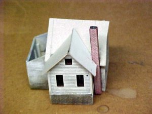

Drew1125
I still had a blank wall on the back, so I scratchbuilt another addition out of Evergreen siding, & added a foundation to it too...I sprayed everything with Floquil primer.

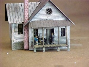

Drew1125
I wasn't real happy with the way the door looked, so I scribed a piece of styrene to look like a plank porch, put a bench & some figures on it...this kind of obscured the door.

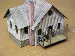

This is what I have so far...still need some steps & some other details.
BDC
Excellent work Charlie! How much did you pay to have that made for you by Shamus? The shipping costs must have been pretty high! ;) :)
I tried doing something like that once. I got past the first step (Buy the kit) and second step (Open the box) with no problem. The third step (Assembly) was a little difficult but I was able to move on to step 4 (Stomp the kit into smithereens out of pure frustration). However, I never took pictures (a good thing) and that building is no longer with me (the trash company came by last Friday). Maybe I'll try more kitbashing later on... :)
