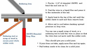

    I wouldn't bother
    to solder the rail joints.
    Even though the NS rail is an improvement over brass, it still isn't the best electrical conductor.
    With Free-MOn30 modules, there is a heavy bus-wire running the length of the layout and every section of rail has a feeder.
    We actually discourage soldering the rail joints to allow for some movement.
    Rail joiners are fine for holding the rails in alignment, but I wouldn't rely on them for conducting electricity or a clean DCC signal.
    I'd only bother to solder rail joints between sections of rail that are small. [Less than 1-foot long] Instead of soldering the rail joiner, I prefer to solder a small jumper wire between sections of rail.
