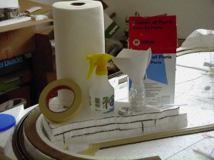

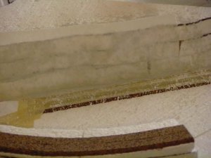

    STEP 1
    First, you will need some materials:
    I used the following:
    1) Plaster of paris (this sets quickly - much preferable)
    2) A spray bottle with water
    3) Masking tape
    4) A salt shaker
    5) A plastic spoon
    6) A paper funnel
    EDIT: 7) And duh, paper towels. (Where is my brain)
    Cover any nearby trackwork with the masking tape, and fill the shaker with plaster using the spoon and funnel.

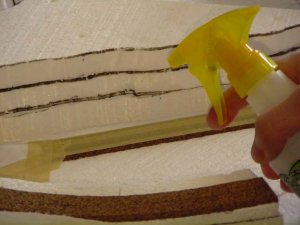

    STEP 2
    Using your sprayer, mist the area you are going to work on. Get it nice and wet. Since foam doesn't take well to water, the water beads up, so get it good and wet.

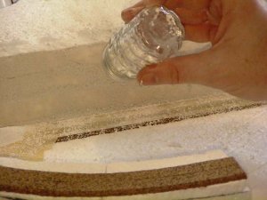

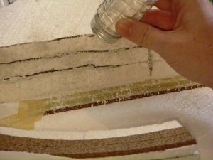

    STEP 3
    Use your salt shaker and sprinkle some plaster over the wet area. Plaster doesn't come out like sand from an hourglass, so you have got to tap the bottom like a ketchup bottle.

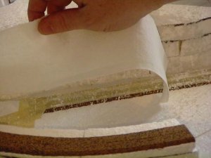

    STEP 5
    While the paper towel is dry, it is easy to cut it to the exact shape that you need. Do this now and apply it to the wet area.

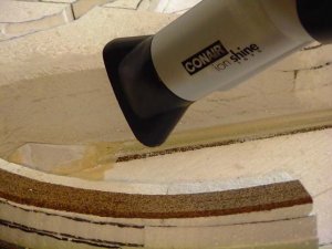

    STEP 9
    I am a little impatient, so I used a blow dryer to dry up any excess run off water. This allows you to dry the area without having to touch your work.
    While this gets rid of the run off water, it doesn't dry the scenery, so be sure not to touch it yet! (Unless you are making changes to the texture by means of some tool... in that case, now is the time to do it, while the plaster is still "pasty.")

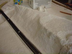

    668
    STEP 10
    Here is a sample area I did last night using the same techniques outlined here. Allowed to dry overnight, it's hard as a rock, but very light weight!
