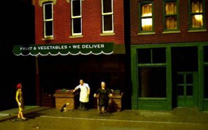

Here's a shot of a couple buildings I did using nothing more than a brushed-on coat of Val's quick brick mix. The one on the right is very weathered, while the one on the left had the bricks painted red - another typical sight around here.

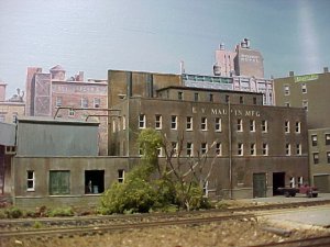

Here's a DPM structure on my layout...
I'm no "master painter", so the process here is pretty simple...
I started by spray-painting the entire structure Floquil Roof Brown...
Then, I painted the molded-in windows & doors, & foundation with a small brush...(I removed a couple of the doors, & "boarded up" some of the windows to give it some "character")
If you mess up painting the windows or doors, it's not really a big deal..just go back & touch it up if you need to, & weathering will kind of take the edge off of any glaring errors.
I thinned some Polly-Scale Aged White with rubbing alcohol, & brushed it over the entire structure, doors windows & all...then I immediately wiped it off with a dry rag, wiping DOWN the sides of the building.
After this, I spray the entire structure with a spray bottle of India Ink, & rubbing alcohol.
These successive washes really give the building an aged, dirty appearance.

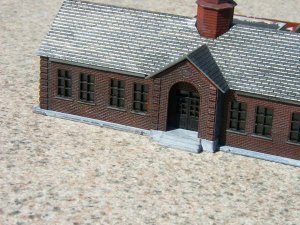

Here's my first attempt
Thanks for all your input. I've soaked up all that you've said and looked at the links and a few books that I have and came up with this. It was a bright red to start with and all I did was paint it with a heavy coat of acrylic mortar color that I mixed up. I waited for it to dry slightly then took a coarse rag and wiped the surface. I cut all but about 14" off of the bristles on an acid brush and used it to clean up the hard to reach crevices and the subborn areas. I tried a very light drybrush on parts of the back and I seem to like how that turned out better than the front I then finished it up with an india ink/alchohol wash. I painted the roof with metalic silver acrylic and used the ink wash to age it.
I will try some of these other techniques on a few others that I have, especially the DPM. I like the idea of reworking some sections to indicate areas of maintenance, and I may just go back and do some major rework myself. Hey, I have less than $5 invested, if I screw it up too bad, no big deal.:eek:

Thanks guys. I'm hoping that I can get better as I go. I'm not that happy with the roof on this one, but I posted the picture thinking I'd get some feedback on what I did right or what I could do better. I apprecate your comments.

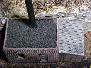

Here are some examples of different type roofs that I use...
This first one is of a small brick boilerhouse, with a wooden "lean-to" addition...For the brick section, I used a piece of plain styrene, painted black, brushed on some full-strength white glue, & sprinkled on some Woodland Scenics fine cinder ballast, to represent an asphalt roof, & for the "lean-to", I used some Evergreen V-groove siding, painted it black, & then dry-brushed it a silver color, to represent a tin roof.

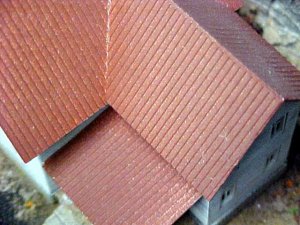

Here's another one where I took some Evergreen clapboard siding, turned it sideways, & painted it mineral red.

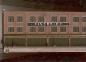

Here's an example of a kit I just finished using the aging brick method I described above. The mortar has been aged and may not show up too well in this scan, but looks good up close
Matt--Hershey, Pa.
