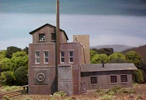

msh,
If you're having problems with gaps around the base of the building, just pile some junk, &/or foliage to hide the gaps.
This building had numerous gaps around the bottom, so I just kept adding stuff until I hid them all.
