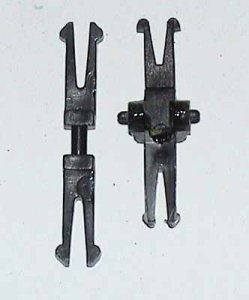

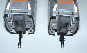

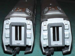

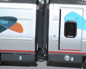

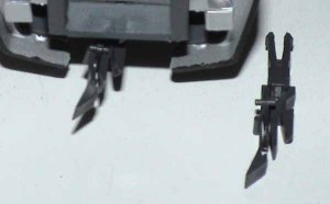

Coupler details
Here are some detail fotos of the couplers and coupler box. The new drawbar for the connection between loco and car was made from two standard NEM (european style) couplers. The short couplers are from ROCO. Bachmann used NEM coupler boxes and short coupling kinematics. I included pictures of the self made new drawbar comared to the original, the coupler box on a car end, detail foto of the ROCO short coupler and two cars coupled with ROCO couplers.
Hope it'll help.
Tobias

maglev
May 27, 2006
31
Wow! great photos! yes, now I do see the problem. If you aren't too busy, could you show pictures of the train with the door open, and the lights on, and maybe the train tilting? I've always wanted to see these things.

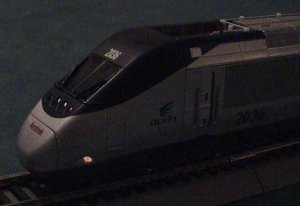

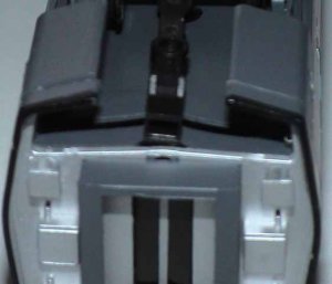

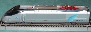

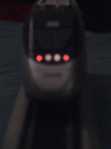

Did a little foto shooting,
here are the results. I used the dummy loco for the pictures, much easier to show the lights turned on. The cars tilt only in curves, like the real ones. There's some kind of curve on the upper side of the trucks. If you swivel the truck, it "leans" into the curve. As mentioned before by green_elite_cab, you can only hold the doors open with a finger or so. The cars tilt in curves on the layout and the couplers are mounted flexible to follow the move of the car it is mounted to. But you can hardly notice it. Saw the price for a trainset including tracks and power pack in the US. Huuuh, seems I was very lucky to get mine for only $150.
