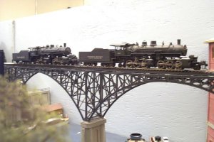

While poking around at an antique store, I found a 9" X 13" black and white photo of Sierra Railways #38, the prototype for the United model.
They are a little noisy (gear tower whine), but otherwise are great running engines. Originally built as oil burners, I've converted mine to coal burners, adding a single cylinder mechanical stoker.

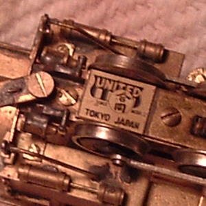

Finally Have Pics
They arn't the greatest pics but it should give you an idea
