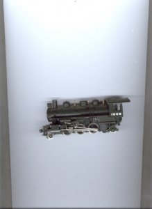

Thanks for all the suggestions folks! Upon closer inspection of the loco as it tried to pull a string of 7 cars up the grade, I noticed that the middle driver was tending to "spring" up off the rails leaving the other two drivers on the rails. Very slight pressure from a finger on the top of the boiler pushed the offending driver back down and it began to pull the cars along no problem. I'm assuming it may just need an ounce of weight added above the middle driver. Now comes the question of exactly how to do that. I have a couple lead weights in my parts box that I could use but see no way to detach the chassis from the shell. There is a small screw on the bottom that when removed does nothing. There is also a small screw below the trailing truck and a small screw on the side of the chassis between the drivers and the trailing truck. None of these seem to be the answer. There is a smoking unit in the smokestack and no long screw thru there like there is on some other steamers I have seen. If I can separate the two sections then how would I affix the weight to the inside? Hmmmmmm...... Here is a visual of the little engine that "couldn't"

Is the small screw on the side of the chasis one that goes through the side of the body into the chasis? If so, look for one just like it on the other side. The body may be mounted like the old Bachmann Consolodation with one screw in the back of the cab and one on each side of and just below the boiler.

Russ: You may have pointed me in the right direction here,but I'm still having trouble. I found another small screw in front of the front set of drivers behind the driving mechanisms, and on the opposite side of that screw, what looks to be a tab. The problem is that the "tab" doesn't depress after the screw has been removed. Trying to pry off the boiler from the chassis with a small flat-head screwdriver doesn't seem to work either as I'm afraid of using too much pressure and damaging something beyond repair....The back end of the chassis is loosened enough from the cab area to allow it to come loose to some extent, but not enough to access the interior of the boiler. Why are things so (insert expletive here) difficult?!?!?:mad: :mad: :mad: :mad:
