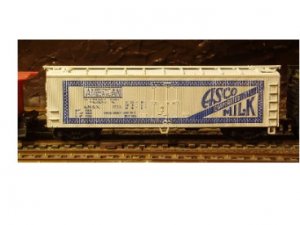

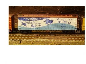

Train Minature old reefer
A view of a few Train Minature reefer cars.. Opps these are small.
