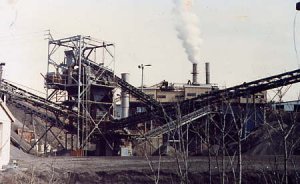

I used to go past this aggregate plant near Mt. Marion, NY every day and always wanted to include a model of it on a train layout. I took this picture ten years ago as a reference during a visit to my home town but then put it aside.

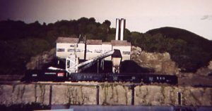

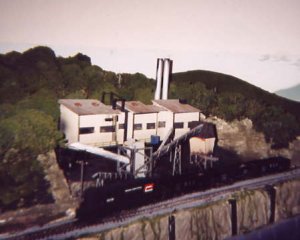

Thanks everybody! You're all so encouraging it makes it fun to try new things and show them off. I'm happy with the way this came out. I took a risk and cut into an existing scenicked hillside to add the industry. I think the conveyors make it look busy. Here's one last pic from a little further away.

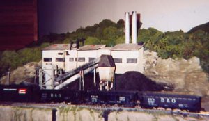

Oops! Yeah I really did a good job modeling that, huh? Can't tell it from the prototype! :D Here's the pic I meant to post!

Fantastic modeling there, Ralph!:cool: :cool: :cool:
Isit a kitbash? Scratchbuilt? Alittle of both?:)
(inquiring minds want to know!:D )

Thanks Charlie! Its mostly scratchbuilt with scribed styrene on the main structure. First time I've used it. I need more patience and practice cutting it. The hopper structure on the left side that the converyors sprout from is framed by sections of an Atlas bridge. I used Walther's conveyors. The loader toward the right side of the pics is made of good ol' carboard.
