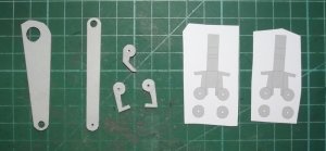

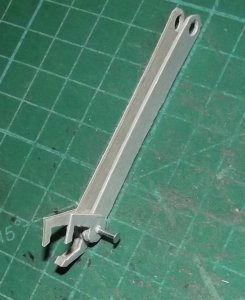

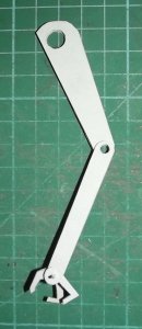

Here are the first pics of the arms. The wrist is very small (if not tiny). As a result of this, the joint cannot be made with a paper tube; I'll use some wire instead. The holes were punched through the single parts with a nail and a hammer. The last two pics show how everything will move in the end.
I made an interesting discovery. If you skip the cover of the two side parts of the "hand" you may equip Crichton with an extra finger. This would dramatically increase his movability and make the hand look more like a real hand. I'll add it as an option (albeit it is not canon :cool:).

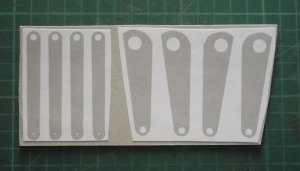

Hey RF, great job on Crichton. The movable parts are just awesome. Was wondering are you using a spray on adhesive when you laminate the pattern to the cardstock? And what cardboard cardstock are you using? Just a couple of questions I've been meaning to ask. Thanks for all you do.

Since the parts are not that big I'm using Elmer's glue for laminating. Sparingly, only a few drops, spread over the back side of the part. The cardboard is recycled cookie packaging. It is approx. 0.65 mm thick so I use several layers to achieve the desired thickness. The laminated parts will be glued to the back or the inside of the actual arm parts (I'll explain later). So the area around the joint is reinforced and the part itself becomes sturdier and doesn't bend too easily.

First of all, please let me explain what I meant earlier concerning the laminated parts. Since the arm parts are very thin but long it is necessary to reinforce them somehow. In addition, you must not make them too thick because the joints wouldn't work any more then. All arm parts consist of two side parts and a strip connecting them. If you laminate the parts to cardboard as usual you'll have to adapt the width of the rim strips. At a certain point these strips would become too thin; they would work then, though, but it would be very difficult to work with them. So I came up with another idea which solved two problems at the same time.
The laminated side parts are glued to the inside of their counterparts on the arm part. This gives the arm parts additional strength and a base to which the rim strips can be attached. So flaps are not necessary. The rim strip is connected to the side parts which ensures that the parts have their proper width when assembled. If you work carefully (like me ;-) ) everything should slip into place seamlessly and stay movable.
