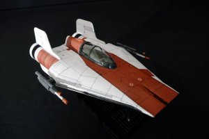

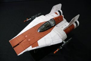

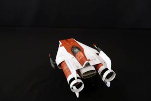

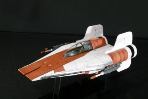

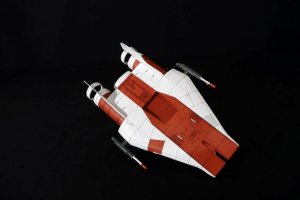

Hi,
here is my latest model, an A-Wing Fighter from Star Wars. Yes this time no Star Trek model!
I found the model several weeks before on this side:
http://www7a.biglobe.ne.jp/~sf-papercraft/Gallery/Gallery.html
I made a little modification, I build a cockpit with a transparent canopy istead of the original paper-canopy.To cut a long story short, here are some pictures:
regards Loenf

Nice work Loenf! The red and white color scheme really pops. What did you use for the clear canopy part of the build?

I used the foil from blister packages. I built the canopy out of paper( negativ form), than I filled it up with gypsum. After the gypsum was hardening I was sanding and rounding the positiv form. This form I used for deep-drawing the foil from the blister pack. I heat the foil up with a heat-gun and pressed the hot foil over the gypsum-form. I had several attempts for the best result (more than 10), different blister packs, different thermal properties!
regards Loenf
