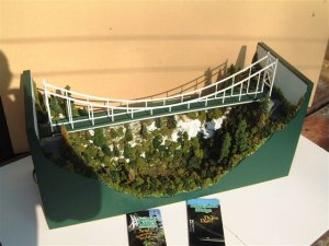

Even though not a strictly 'railroad' bridge, I thought the 'bridge fans' might like to see this one. It's a diorama I just finished, featuring a pedestrian suspension bridge, currently being built at Scenic Caves, near Collingwood.
This model will be going into a display at a tourism marketing venue.
It's approximately 87:1, but heavily compressed for length, as the real bridge will be over 400' long.
I had to use wood for the 'cabling', after being unsuccessful in soldering up brass shapes and music wire into the cabling.

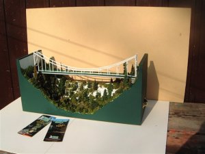

Another view:

Mike, excellent bridge. What did you use for the facia surrounding the diorama Looks great. ...Tom

Tom;
The basic 'box' was built with 5/8" particle board, all straight edges with 45 degree gusset corners.
The fascia is 1/8" Masonite, freeform jigsawed. I glued my blue styrofoam up to the Masonite edges.
Paint on the Masonite is just Hunter Green craft paint, "Plaid" brand.
Then spraybombed clear acrylic.

Thats a great looking bridge, a few HO scale figures walking on it
and one taking photos of the valley at the middle of the bridge would kick your super dioarama up a notch.

Valid points, but there's a couple of reasons why there's no figures on the unit.
The prototype is 410' long, but because my client's display case width was limited, I had to compress the model a lot. It only scales at about 210' long. To partially compensate, I made the 'guardrails' lower [about 120:1.......TT still lives !]
I tried a few LPB's on it when I was done, but to my eye, they made the bridge appear shorter.
The other reason is that I quoted the client the LPB's as an extra $ item, and there was a bit of "sticker shock". I told them I could always add figures at a later date if they wished.
