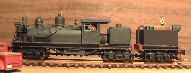

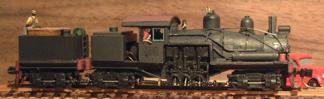

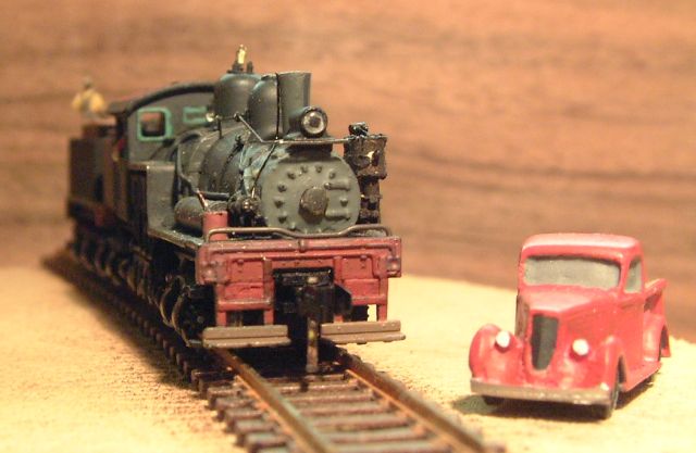

Hello Shay-fans
Last saturday, my secound Atlas-Shay arrived. So i could start another project, to build a 3-truck Shay out of 1 and 1/2 of this Atlas Shays.
And here is the result. Most of the details are still missing like airpump, waterpump, wooden boxes, figures, letters and so on.
But even more importend is, that this engnie runs great !!!.
I'm using the third truck for electric pickup. The middle gear has been removed, to let the wheelsets turn free in the truck. I've also removed the bevelgear on lineshaft. So the driveline will turn free and runs very smooth.
The frame of the engine has been shortened to get the rear truck closer to the cap. I've only shortend the rear end of the frame and this is the smallest version you can get. You could also shorten the front section and Shay would be even shorter. By shorting the frame, the flywheel in the cap has been modified to fit onto the new chassie.
Now, I've removed the airtank and airpump on the shell at the boiler and cut away the runboard. I've then added a new one out of brass. Also the frame has been modified to represent a old style U-beam frame. I've used 2x1mm U-shaped brass for this. The oiltank is out of brass and brings some more weight to the loco. The tender is the original one of the Shay and has been glued to a frame out of brass.
After assembling, The Shay looks real good. It is notexactly the prototype #15, but looks very close to its original loco. And she runs sooo smooth and well... You could run it in "real walking speed" on the track. It's fantastic.
But that will be enough words for the moment....
Here are three pictures of the actual status of my #15. Enjoy the pics and please let me know, what you think about this 3-trucker...
Gerd
