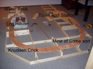

I have built two of the four corner modules I'll need, and combined with the first four straight modules, Here's what we have so far. Planned towns, buildings, scenic elements, etc. are indicated.
The trackplan is really simple. Just a single main line bobbing and weaving through some rugged scenery...lots of rocks, trees, fills, cuts and water. Unlike my home layout, I'll be using Peco On30 track for this one...mostly for tracklaying ease and durability.
As to the corners, they are 36 inches square, and have a curve radius of 30 inches, with 6 inches at each end for joining modules and a (brief) curve transistion. The 30 inch radius should allow me to run any of the up-and-coming K-class locomotives. The town and station area will have a passing track to allow trains to meet. From what I can tell, this passing track could well be up to 6 feet long - more than enough for the short narrow gauge trains I'll be running.

Kundsen Crick? That name sounds farmiliar.

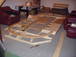

Well, the 2 last corners are done, and the legs are under way. I've even started putting in the wire mesh scenery support on one of the modules.

That's also the name of the creek on my micro layout, great minds think alike or what? Looking good Steve!

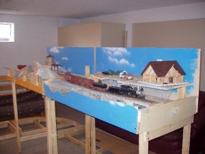

Well, the mine just beside it is likely to be known as "Tyson's Folly".
Well, the legs are coming together, and I have roughly put on the backdrop, as well as starting to work on the front fascia...which will not be blue... Here's a shot:
